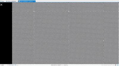

I managed to build a stereo model to view the aerial photographs in 3D and be able to photointerpret.
Now I want that same project to open on another computer.

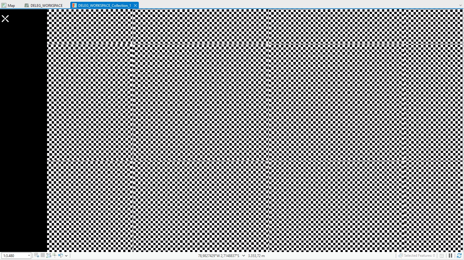

I went through the entire folder that contains the information, but when I open it on another computer, it does not show me the 3D photograph, and it shows me another image.
If anyone can help me how I can solve this type of problem, I will be grateful.
Robert_LeClair
Esri Esteemed Contributor
For the other PC, does it's ArcGIS Pro have licensing for the Image Analyst extension AND meet the requirements for working with stereo mapping?
JairoCordero
Hello, yes, the PC has the license for the extension and meets all the requirements.
JeremyWright
The checkerboard pattern indicates that the mosaic dataset's image data links are broken. See https://pro.arcgis.com/en/pro-app/latest/help/data/imagery/repairing-paths-in-a-mosaic-dataset.htm
