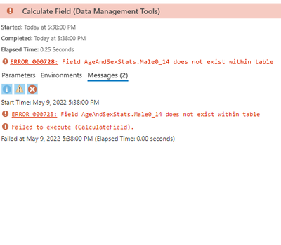

could you try doing the join in the other direction?
aam
I get this error if I do the reverse join.
RhettZufelt
MVP Notable Contributor
You can do a "reverse" join, but you can only calculate on the original table, not the joined table, or it will give you errors like you see.
