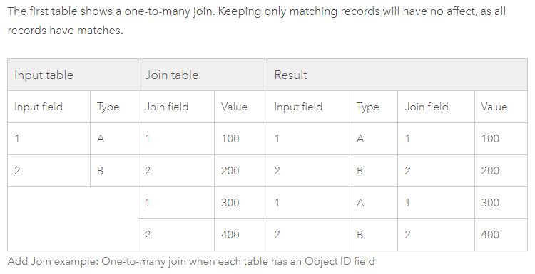

Aren't joins in ArcGIS Pro one-to-many?
Add Join (Data Management)
Whereas joins in ArcMap were one-to-first.

My understanding is that joins are also one-to-many too.
Maybe @JonathanNeal could comment.
