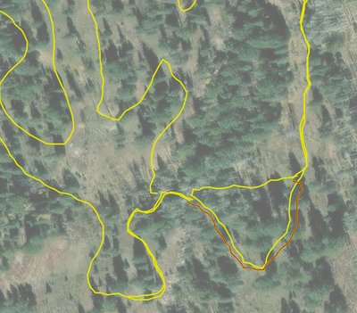

Same thing here but with lines. I have a hosted feature layer with data collected in Survey123. The exported feature class has the attachments and all records in the attribute table but the geometry is all the same single feature. Incidentally this was the last feature collected. Screenshot shows yellow lines of original data, red line shows exported data.
FourCornersMapping
This is a known BUG 000172816. The workaround is to use the Copy Features tool, which works as expected and preserves attachments.
