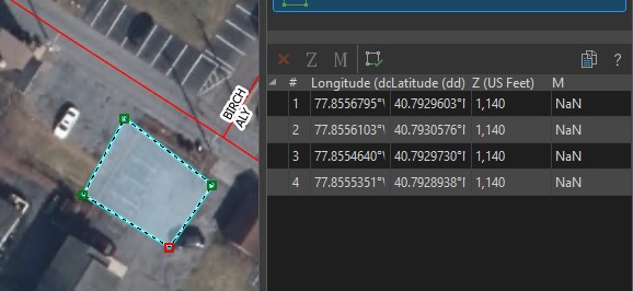

We're experiencing a problem where we have 3D buildings that have different Z values.

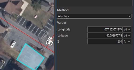

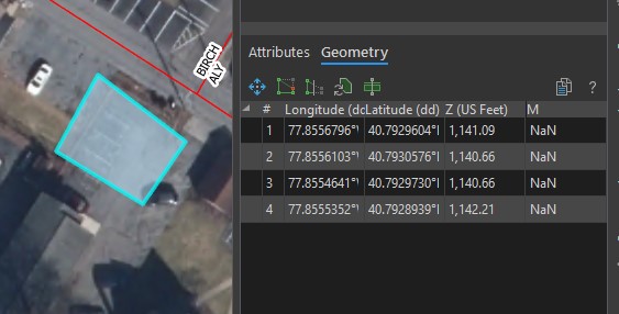

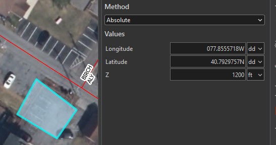

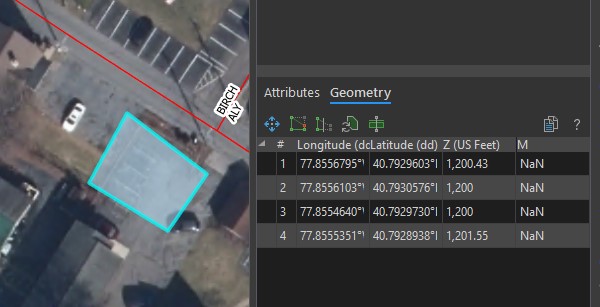

When we use the MoveTo tool with the Absolute option it doesn't actually move all the vertices to that absolute value.  If we say we want these vertices to be at 1200 ft the MoveTo tool will add / subtract the variances from the previous values into the new values.
This means the Absolute option did a combination of moving to the specified elevation and the delta option by adding in the difference.

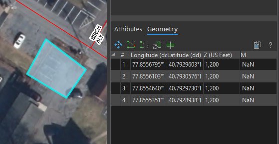

Now... if the vertices of the polygon are all the same.
Then I run the MoveTo tool 
This does what's expected and calculates all the vertices to be 1200

The MoveTo tool works on the features anchor point and all the feature vertices are moved relative to that, otherwise you would end up with all your X and Y values at the same location too. Z isn't special here.
