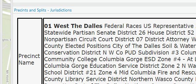

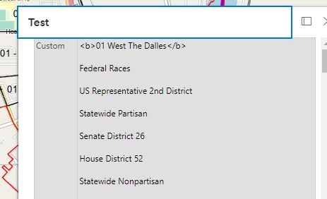

Which does this in Pro (ignore the bolding, I know that part won't work in the web map)
Spoiler
And this when it is exported as either a web map or service (again, ignore the bolding, I know that won't work)
Spoiler
Presumably there is a way to create popups in Pro that will look the same on a web map? Having to guess what it'll look like then repeatedly exporting to a web map and hoping it'll work seems a little clunky.
