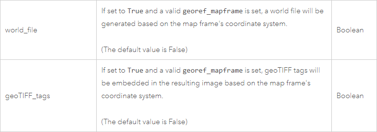

The Pro 2.7 docs imply that it is possible to export a Layout to a TIFF that is georeferenced, either by both embedded geoTIFF tags and/or  by a world file using the exportToTIFF method:
(See
https://pro.arcgis.com/en/pro-app/2.7/arcpy/mapping/layout-class.htm)
I have a simple map series already configured in Pro, and I'm calling exportToTIFF in this code :

As is, this is exporting TIFs  🙂  but without world files or geoTIFF tags ☹️.
How do I set a valid georef_mapframe  in this code such that I would get geoTIFFs or a world file?

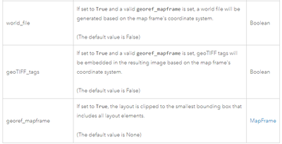

The next row in the table has the answer (even though the description of the parameter is obviously incorrect):
You need to pass the MapFrame that will be used to setup the georeferencing. Here's a basic example. This does export with both the tags and tfw file:

JeffBarrette
Thank you for bringing this to our attention.  This was obviously a copy/paste error that describes clip to graphics.  As Tim suggests, the georef_mapframe parameter is what allows this to happen.  We will fix the help topic.
