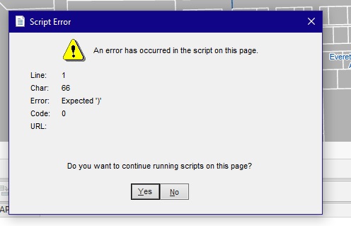

We have paths and file names with special characters:  L:\Path\MATT'S ADDN BLK 1,2,&3.TIF.  I know this is a terrible thing to do, but it was done long ago before my time here.  My guess is it is due to the special characters.
The paths are stored in an attribute and I am using that as a hyperlink in a custom popup.  The ones which do not have special characters of course open fine.  But I get the following error below on the ones that do. Hitting Yes does nothing.
This is not a problem in using the ArcMap hyperlink (lighting bolt).

The single quote is causing the script error.  I don't know of a way to work around this in ArcGIS Pro, other than removing the single quote from the file names.

MarkBockenhauer
Matthew,
I tried using Arcade to workaround the link issue, and I think internal Popup window code is interfering.  I have raised this with the team that works on Popups.
For example when a file path is typed in, the popup changes the string
The popup link trips over the ' in the file name.
