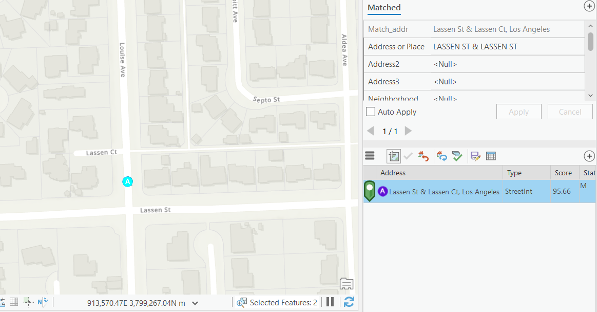

Hi. I'm using the Create Locator 2.9 tool to build a Locator for matching street intersections. I would like the locator to prevent matching invalid intersection locations. For example, in the screenshot below it is an invalid street intersection address that I do not want the Locator to match. Lassen St & Lassen St should not match in this scenario. However, the locator matches to a location on a perpendicular street between the two parallel streets (Lassen Ct & Lassen St). Not only that, it gives it a pretty high score that would not make it possible to find in a large dataset through score alone.
I realize it would be possible in this scenario to flag this location before geocoding, but seems like this should be preventable (or at least scored significantly lower) when setting up the locator.
Is there a way to prevent this from matching or scoring lower that I am not aware of?
Thanks.

You can increase the minimum match score and minimum candidate score to 96 and this intersection wouldn't match during batch geocoding or return as a candidate when searching in the Locate pane.

Thanks Shana. Adjusting the minimum match score would exclude this record, but numerous valid matches as well. The score is way too high to differentiate it from other valid geocoded locations. I think the matched score should be much lower for this scenario.

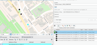

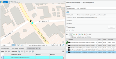

And since another example came up in our work, I'm adding a second example showing the same issue with another outcome for reference.
This intersection address at San Fernando Rd & Cypress Ct does not have an exact match. However, ArcGIS Pro gives multiple candidates. The first image highlights a near intersection match between San Fernando Rd & Cypress Ave.
The second image shows a location slightly further north where San Fernando Rd intersects a Cypress St. This seems like a more likely candidate for our work, but it has the same score as the near intersection so is not matched in this example. If the near intersection was not active for this we would have matched to the more likely result.
