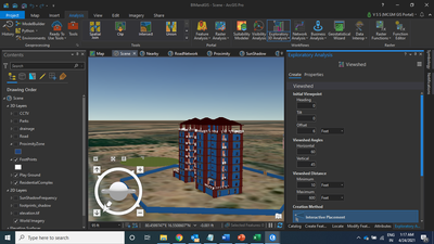

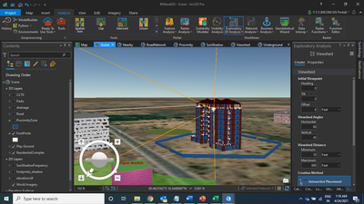

Here is the set of tools available in analysis tab in ArcGIS Pro (Refer Screens shot),
Step 1: Exploratory Analysis under the Analysis tab
Step 2: Select Viewshed tool
Under Exploratory Analysis Viewshed tools set the following parameters
i.e. Initial Viewpoint, Viewshed Angles, Viewshed Distance and Select the creation method. (Refere Screenshot)
Step 3: Place the cursor and click the elevation point from where you wants to see the visibility.
