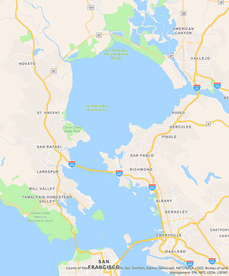

Yup, I've tried exporting a layout... same issue. I'll try to give a better description:
I have an area which I'd like to export as an image:

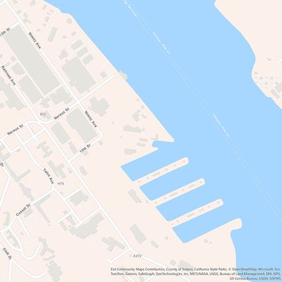

When I zoom in to a small area of the above, more details are shown (obviously):

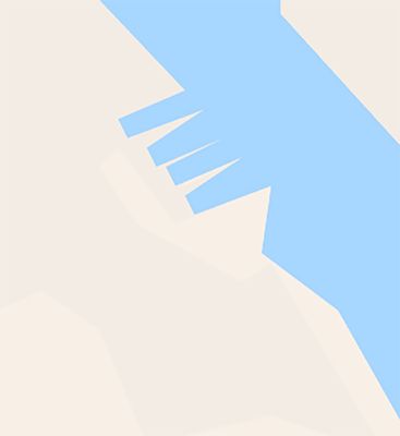

When I render the first view at, say, 12000 x 14000, the level detail is like this:
The goal is to render the large area view, with a level of detail like the second zoomed-in view.
The 14000 x 12000 resolution of the exported image certainly has the pixels to support that level of detail, but there seems to be no way to actually make use of those pixels.
Ideally, I would think that ArcGIS Pro would have a way to define the exported image area separate from what is seen in the interface Map View, along with the level of detail (camera altitude?) but it appears not.

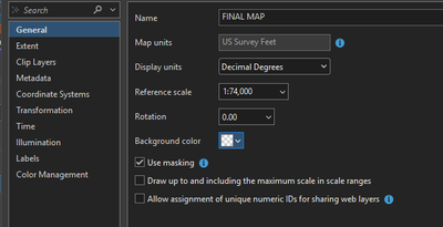

Did you try going into your map properties and setting the reference scale of your map? Don't know if this will work, but could be a potential solution.

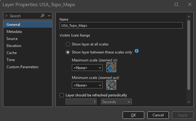

Also, did you try messing with the visible scale range in the layer properties?
