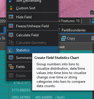

When you right click on the attribute column to compute statistics (screen shot)
The statistics panel no longer computes statistics for the selection.
It computes statistics for the whole table but it is not working for the selection.
3.0.0 and 3.0.1

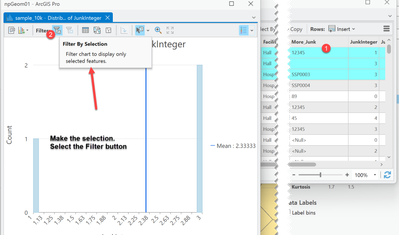

Solved: Field Statistics Chart Won't Filter by Selection W... - Esri Community
couldn't find the bug, but an apparent enhancement has been hidden but is a simple click away.
