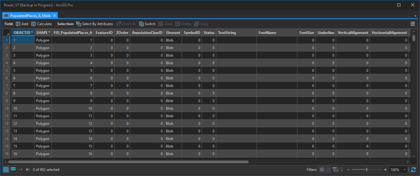

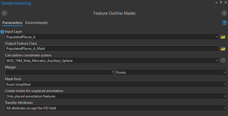

We generate feature outline masks for cartography purposes, but since switching much of our operation from ArcMap to ArcGIS Pro have noticed the Feature Outline Masks tool doesn't work fully when trying to carry across attributes from the  annotation to the new mask polygons. The polygons create fine, but when the problems occurs when the Transfer Attributes parameter is set to "All attributes" or "All attributes except the FID field". Most of the attributes are not coming across.
