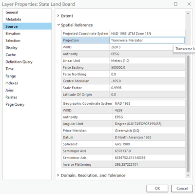

Could you please post a screenshot or copy what it says under Source > Spatial Reference for a layer with this issue? I'm not even seeing that GCS in ESRI's coordinate reference handbook.

I tried to define the projection, and nothing changed. Still have the same issue
