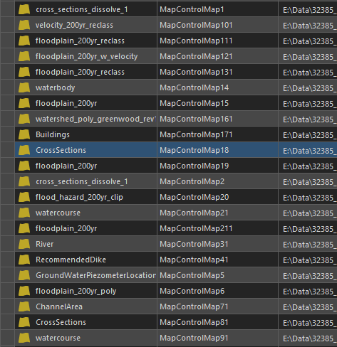

ArcGIS Pro is creating all these map controls automatically, some of them have broken sources and there is no way to delete them that I have found and they are slowly growing. Even worse, the map controls listed are not listed in the project map items.
I found them in the Data Sources panel when viewing all the maps in the catalogue of the project.

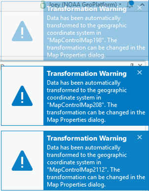

I'm seeing this too. There are hundreds of them. This post is the only thing I could find when searching for "MapControlMap"
And additionally, every time I click a layer in the catalog view to preview the geography there is a "transformation warning" pop-up notification (see below).
I can click back and forth between the same two layers and it will generate a new "MapControlMapXXX" each time.

I just stumbled over these MapControlMaps, when I was packaging a project. Before packaging I klicked the mistake-analysis-button and several MapControlMaps were listed. I then klicked each MCM and repaired the mistake (missing connections or one MCM had no information (layer) attached to it). After repairing all mistakes, I was able to succesfully pack the project.

Like many in this thread, I was greeted with this MapControlMap### error. Sadly, mine equaled more than 2k for my Pro Project that I wanted to package. Yeah, I have somehow entered a meme realm with that number. Obviously, I am not going to spend time linking severed data sources. I created a NEW project, established appropriate project properties, imported the previous work that would, manually fixed the work that didn't, and was able to successfully package the project afterwards.
I have several Pro projects that do specific things for my workflows. I don't typically cross the streams, as it were. One other Pro project also provided the same errors when attempting to package it. This Pro Project is my data management environment: effectively, catalog focused with a couple maps and a scene, where I perform all/most my data handling needs. I almost exclusively do all of my data pipeline work through this Project and would never actually try to create a package with it. This thing has over 4k errors in this same fashion, gross. It seems that, in a Pro project, anything(?) viewed in a map or linked to or temporarily created, or whatever the full triggers are, it is creating a stamp of that existence in the Project's data sources. You can not remove those project data sources, only reestablish their links. So if you are doing a lot of transitory steps or working with temporary data in your workflows in a Project that you plan for packaging, this may be the cause?
