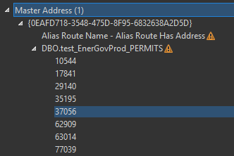

There is a 1:M relationship that is returning results.
Results as shown below:
ArcPro Relate:

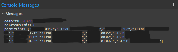

Arcade Script Console from MasterAddress Popup
Actual ArcPro Popup:
ArcPro PopUp Script:

console("address: " + address)

console("relatedPermit: " + Count(relatedPermits))
//console("relatedPermit: " + relatedPermits.MAIN_ADDRESS_LINE1)
console("permitList: " + permitList)

Any help in why the popup is not returning any values, would be apprecaited.
Amarz
I have also attempted to use the following with the same result.. I am getting a console return, but nothing in the actual popup..
