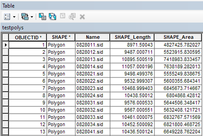

ArcCatalog, New -> Raster Catalog.  Create the catalog, then Load from Workspace to  add all the SIDs to it.
However, it won't let you delete the Raster column now, so:
   make a blank Polygon layer with the only attribute as "Name" text length 256.
   then, start editing on the new blank polygon layer, select all of the polygons in the raster catalog, copy, paste to the new polygon layer.
This will give you a polygon layer with the outlines and the Name field preserved to use for spatial join.
This method will preserve the file name and extension.

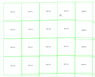

one way would be to create a new Mosaic dataset, then add the SID rasters to it without building overviews.
This will make a Footprint layer (polygons) with the outlines of each input SID image.  You can then 'Export' the Footprint layer to a separate Polygon feature class, and each polygon will have the name of the SID it encompasses in the [name] field.
If you delete the Raster field from the 'new' Footprint layer (need to delete the Raster field from this new FC or it won't let you perform a spatial join against it), you could then use this as your polygon layer, or can perform a spatial join against it to populate your polygon featureclass.

SandyWatford
Thank you for your kind response.  It looks as if that is exactly what I need.
Unfortunately, the Create Mosaic Dataset tool is not licensed for our ArcPro.  I am currently using it under our ArcMap license and thought everything was available, but apparently not.
If you have any other ideas, let me know.  It may be awhile before my company is able to license the tool.
Thanks again

RhettZufelt
MVP Notable Contributor
Other option that just need Basic license.

SandyWatford
Jumping off from your method, I ended up creating a raster catalog and doing basically the same thing.
  1. Create raster catalog (unmanaged)
  2. Workspace to raster catalog
  3. Export footprint from catalog (to new feature class)
  4. Export feature class (from footprint) to shapefile
Thanks again for your help.  You put me on the right track!
