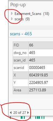

LindaWilliams1
In Pro, with no programming needed, clicking the Explore tool cursor on the map where multiple layers are displayed brings up a Pop-up containing information from all of the visible layers and features. In the image below there are multiple overlapping polygons from two layers listed at the top of the Pop-up, and the arrows to page through the features are located in the bottom left corner. Pop-ups can also be configured beyond this basic display: https://pro.arcgis.com/en/pro-app/latest/help/mapping/navigation/configure-pop-ups.htm.
