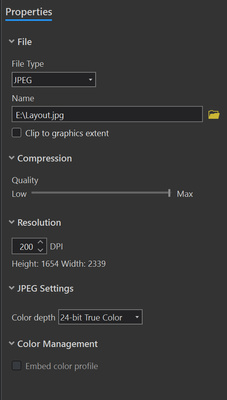

Can you share the screenshot of the layout setting when you export to jpg make sure in jpeg setting color depth is set to 24bit true color as shown in picture below:
JustinSmith
I do have these exact settings. Based on Dan's message above I explored .png more and was able to get the right image. It involved making sure all layers had the same transparency and the same layer blend settings. Thanks for both of your input.
