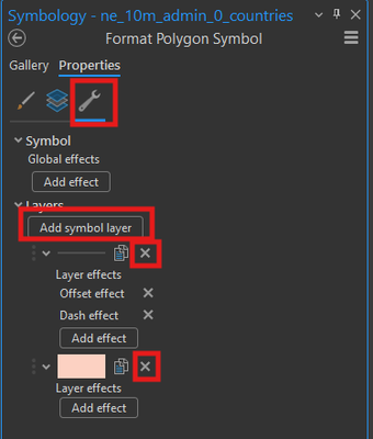

In the Format Polygon Symbol panel that appears, click "Properties" near the top.
You should then see a wrench icon for "Structure". Click that. Here you can add and remove individual components of your symbol, like the Stroke outline and the Fill, which are there by default. If you don't want those, you can delete them by clicking the X next to each. Following the use-case from the original post, you might want to delete the Fill but keep the Stroke in this example. Whichever you do, to add a Marker component you can click Add Symbol Layer, then choose Marker.

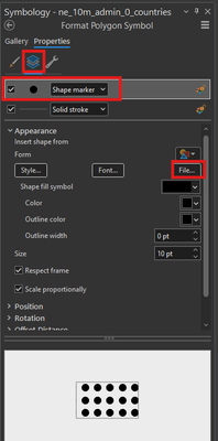

After adding a Marker it will probably show repeating black dots by default. Click over to the Layers menu (still in the Symbology Properties panel, just left of the wrench). Leaving "Shape Marker" highlighted, click the "File" button off to the right.
Now you can add an SVG file. When added, it will probably be still be repeating by default. You'll have to play around with the settings under "Marker Placement". Try Placement: At Center, and then check the box to "Clip Marker to Boundary". Then (back higher up on the panel) up the Size property until it fills the polygon(s) you want it to completely fill (I don't believe there is an option to have it automatically scale to the size of the polygon, unfortunately). Then as described in my original post, set the reference scale in the map properties to lock in the extent and the size of the marker(s).
