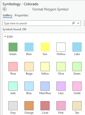

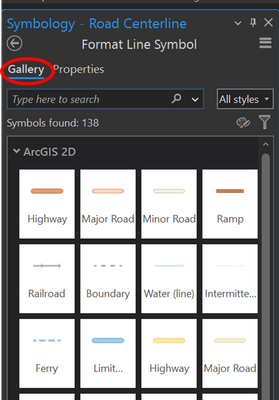

It only shows me polygons, not lines. (first image) In Map I could go into properties and use line styles to change the border of a polygon to a predefined style. But now I can't get it to do that. When I try to change the border, it just takes me to the place where I can create my own template (second image). But I cannot figure out how to access the line styles for polygon borders.

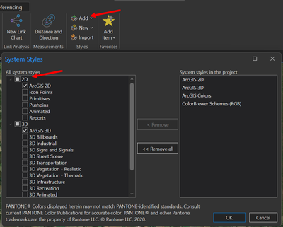

See if this helps. From the Insert tab of the map ribbon, if you choose "Add" in the Styles section, do you see the "All system styles" section? From there you can dropdown and check the "ArcGIS 2D" style.
Eugene_Adkins
If you need to "Import" the style to the aprx, you can choose the "Import" option (instead of Add) and then navigate to the styles you downloaded from ESRI. From there it should become a part of the aprx you're working with.

Thanks for chiming in again! I imported the first time I tried it, then I added it the second time. The line styles do show up in my project if I apply them to a line shape, but I can't get to them for a polygon border. I must be doing something stupid, that's usually the problem.

Ok. One thing to keep in mind (it may apply but it may not) is that Pro is dynamic when it comes to symbol styles and features. So, if you want to see polygon styles you must be adjusting/changing the symbology of an actual polygon. So, in other words, if you click on a line feature you will only see the style options for a line feature.
AvaFarouche
Yep! I've been adjusting the symbology of a polygon. I have, for example, a state, and I want the border to show up as the predefined line style of a state border. I can change the fill of the polygon, and I can change the border insomuch as I can change the color, add a layer, make it a dashed line, etc., etc., but I cannot access the line styles for those polygon borders. Thanks for taking the time to reply! I did end up just re-creating the old Esri state border line style, but this comes up a lot and I would like to be able to access all of those old styles and not have to re-create my own every time, or save my own styles, I guess.
