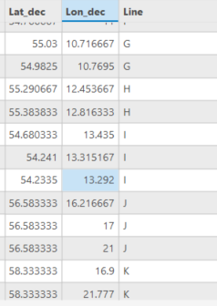

I need to create some geodesic lines from points I originaly have in an Excel table but they are imported to ArcGIS PRO 3.1.
The coordinate points has an identifying field to determine what coordinate points should be used for what line and I can easily create the lines using points to line, BUT there is no option to select what type of line that should be created as in "XY to Line" that has the options:

To use the "XY to line" doesn't work for me as I have several node points that should be connected along the line, and those tools needs a start and end point per line derived from different input fields.

Your data aren't currently in the form to use
XY To Line (Data Management)—ArcGIS Pro | Documentation
Your data will need to be rearranged.

I am aware that the coordinate list isn't fit for use with the XY to Line tool, but was hoping that there where another way to do it using a tool similar to  "point to line". But it appears as the Point to line simply draws a straight line regardless of what reference is given to the map presentation.
The dataset has been assigned the correct geodetic reference.

It seems as only the endpoints are stored when the "point to line" tool is used as the line becomes straight regardless of what projection the map is shown in.
I will have to rearrange the dataset and use the "XY to Line" tool instead, even that it will take some time to do it.
