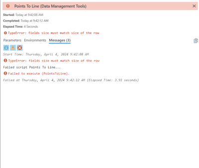

I am getting the same error when I run the tool directly in ArcGIS pro.

I was able to work with Katie yesterday on this issue.  There certainly was not much reference to this in any forums or documentation.  It turns out that the field being used as the Line Field in the Points to Lines tool contained a starting pair with ORIG_ID = "0".  The table was not sorted so it was not obvious where the error was occurring.  Once the zero was changed or removed the tool worked properly.  Hopefully this is helpful to those who might encounter this issue.
KKing
I found that this tool had the same error when there were any columns with <Null> if that is helpful. I filled the <Null> with NA and then deleted those lines as a work around.
