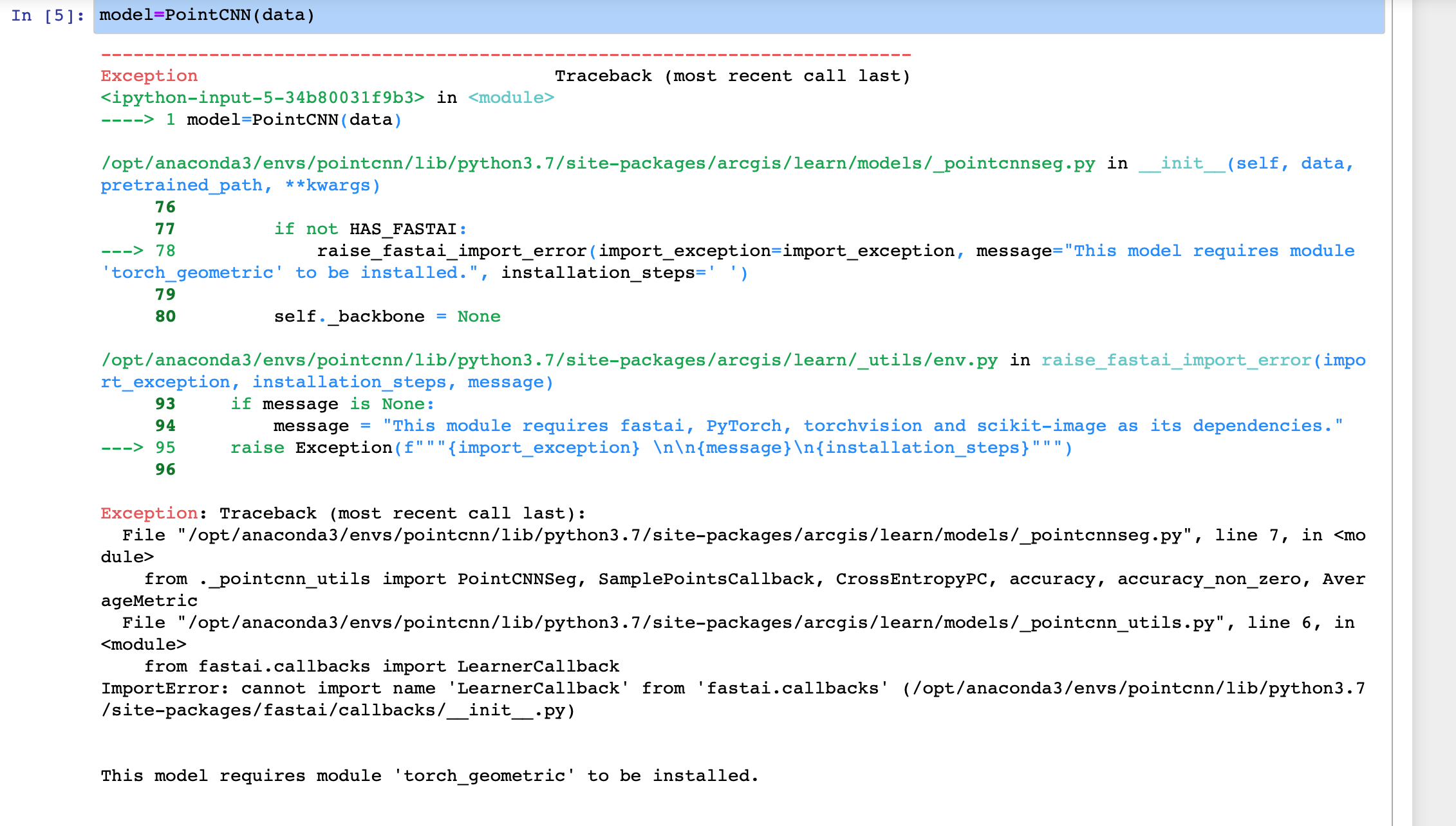

 ESRI engineer, what is the configuration of pointcnn model environment mentioned in the developer conference? I will install api1.8, and prompt that you need to install torch geometry, torch spline conv, PIP install torch cluster, torch sparse, and torch scatter. The official advice of installing torch is to install torch 1.4, but it still reports an error。

AbhishekPandey
I was facing the same problem but here's a solution. open arcgis python command prompt, type "jupyter notebook" create a new notebook and carry out ur training in that.

Hello, now that I have solved this problem, it seems that there are new problems
