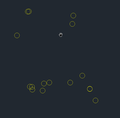

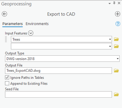

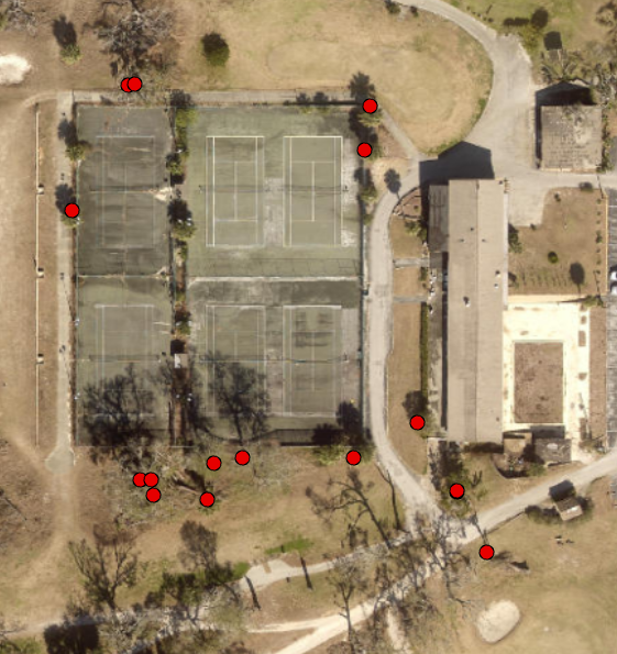

Hey Question for y'all, anyone know why when i convert a point shapefile to a dwg file via the Export to CAD tool, i get circles instead of points. I've tried changing the symbology to X's and changing the symbology size. Still get the circles.
As reference I'm using ArcGIS Pro 2.9 and Autodesk DWG TrueView 2022

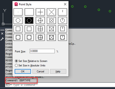

Hello Richard,
This is not a bug, but a symbol applied to the point for the CAD layer. You can easily reset the style of the points by using the "DDPTYPE" command in AutoCAD and selecting the style you want to display the point with.
I hope this helps!

RichardHowe
I believe this is a bug. I'm seeing exactly the same behaviour on ArcGIS Pro 3. Even when adding a CADType field to attributes and specifying POINT in the field (which should force the geometry) does the GP tool produce large circles instead of points. In direct contrast to what the technical help suggests (i.e. points become points, lines become lines)

PrasantaBhattarai
Hello Richard,
I hope this helps!
Regards,
Prasanta.

RichardHowe
@PrasantaBhattarai Thank you for this. I can confirm this is the issue we were experiencing. Thank you for the help. I'm off to drag our CAD operative over hot coals...
