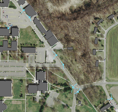

Here is the layer in ArcGIS Pro

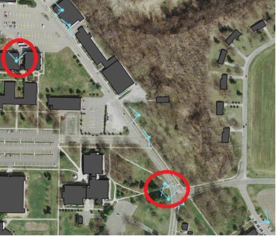

Here it is in Enterprise Portal
Note the two red ovals in the Enterprise Portal.  In the one on the left, the point has been moved to the middle of the building, in the oval on the left, the two blue circles should be essentially on top of each other, and reversed in north-south position.  This is not a coordinate system issue--that wouldn't reverse the position of two points and move them away from each other.

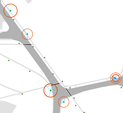

It's been awhile, but got a little time to play with this.  The issue has something to do with the determination of the "center" point.  I modified the symbols in ArcGIS Pro to include a circle marker, centered on the small circle, that is sized to cover the "wings" of the symbol.  I thought I would be clever and make it transparent.  ArcGIS Pro and the map image layer worked fine (as they always have), the feature layer still got it wrong.  So then I colored outline of the large circle.  This worked, but obviously, it is not the symbol I need.
The symbol is supposed to represent the view of a security camara.  Some poles have more than one camera. The symbols have been created so that the small colored circle is centered on the the location of the camera.  Anybody have any ideas how I can force these eccentric symbols to rotate around this point?
