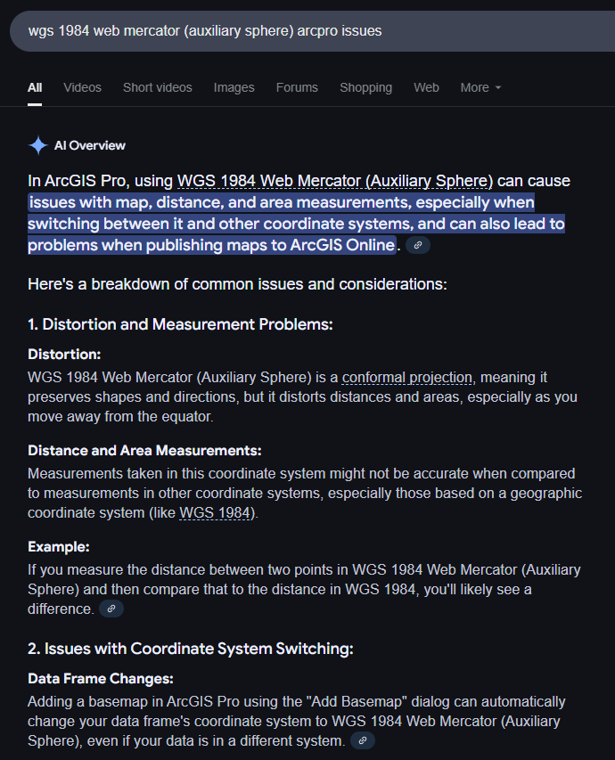

I think I figured it out. It has to do with conflicting/different coordinate systems between layers in the aprx I'm using to generate maps. The layer with the offset is set to wgs 1984 web mercator (auxiliary sphere), and the others set to their local state plane coordinate system. According to google and other forums, that auxiliary sphere coordinate system can cause projection issues when there are other layers in the aprx with different projections/coordinate systems... See my attachment below.
