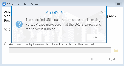

Note: There is no other way of authorising Pro asides from the above, even though loading licence files is given as an option in the application (see pic below):
I understand you would like to know if it is possible to authorize ArcGIS Pro Beta 5 without logging into ArcGIS
Online.  Unfortunately, there is currently no way to authorize Pro Beta 5 without signing in with your AGOL
credentials.  -esri support
In my case, in addition to the above, my browser had an extremely restrictive set of internet security settings (no active scripting, etc) which meant that I received errors like "ArcGIS Pro: The specified portal could not be set as the Licensing Portal.  Please make sure the URL is correct and the server is running."  (The URL was default: http://www.arcgis.com)
Once overcome, the logon box (IE custom window?) that appeared had almost nothing in it (just a few words), so it was impossible to use Pro.
You must allow javascript to be able to log in and authorise Pro.
