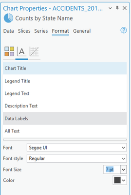

ChristopherAllen
Hi @SeraphinaOettli , in addition to Robert's great suggestions, you can also try playing with the size/formatting of the data label text in the Format tab of the Chart Properties pane:
But in general we hope to improve the placement of data labels in an upcoming release, which you can track with ENH-000151672.
Thanks for your feedback!
