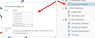

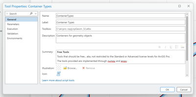

You can do it with the new toolbox format (*.atbx)
Document a custom geoprocessing tool—ArcGIS Pro | Documentation
but not for the old format (*.tbx)
Create a script tool—ArcGIS Pro | Documentation
I usually find creating the toolbox and the tools easier using the custom tools dialog rather than the *.pyt format since the *.atbx can be viewed and to some level edited in 7zip

I find the validation code and all the other stuff in the "custom" toolbox and tools gets included in the dialog itself, so I can just edit it there rather than coding from scratch.  Once done, it all ends up in the *.aptx and I can edit (not recommended by esri staff ! ) as I see fit.
Besides using the custom toolboxes allows me to do screengrabs to document script parameters and the inputs I used.  A picture goes a long way to refresh the memory 😉
