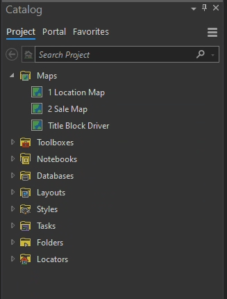

My aprx I created with the intent of saving as a Project Template somehow has more maps than are listed in the catalog pane.   These four phantom maps cause an error when I save as a Project Template, so I would like to remove them (and find out where they came from if possible).

However, the catalog pane only shows three maps (1 Location Map, 2 Sale Map, Title Block Driver):
I was able to get the Project Template to save by removing all layers from the four phantom maps through a python script, then adding a blank layer back to all four.  But, the maps still persist and may cause future issues.
Any ideas on removing these maps, where they are being stored, or where they came from?

The problem I have is the four phantom maps that need deleted are not listed in the project's maps folder or any of the other default project folders.  I have only found them in the following 3 locations:
  1. Running listMaps in python
  2. Manage Data Sources from the catalog view.
  3. When a tool or process fails the layers contained in the phantom maps are referenced
I cannot find a way to directly interact with the phantom maps and unfortunately the layers that are causing issues are all feature services and are not able to be edited from Manage Data Sources.
