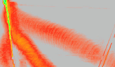

Yeah sounds weird, but when I simulate a heavy rain scenario, set the export interval to 10 seconds, and then calculate the maximum water depths from each export, it creates wavy-looking data like here:
The faster the water flows, the greater the distances between the waves. So if I set the interval to 1–2 seconds, it would at least reduce the likelihood of generating such “waves” in certain places.

If the waves are the primary issue, then there are two configuration options that help reduce that effect occurring in the math.
Are you using the following options?
1. Set a Roughness value.  Even a hard-coded value for the whole scenario, such as 0.035, will reduce the way the core (St Venant) equation can result in a build-up-and-release of water as it starts its initial movement (eg: over small barriers, etc). If you're able to use a raster to define variable roughness over the AOI, that will also help with movement speed and accuracy.  (Note - the infiltration options also help a little).
2. Use the 'High' temporal resolution option. This does 20x more calculations per simulation-second than 'Low' temporal resolution, which allows water to move downhill in smaller levels (fewer large waves).
If you're already using both these options... then maybe the "heavy" rainfall rate you are using might be creating deep/fast flows that are not well-suited for the shallow water equation model.  ☹️  If the value is extremely high - as in, "not experienced by humans before" - then you should do a longer scenario with a smaller / feasible rainfall rate.
Otherwise, the general method of exporting multiple results to generate per-cell maximum water levels is solid - it's the volume and size of the export that is taking the time.
