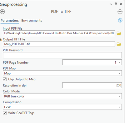

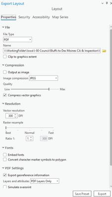

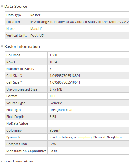

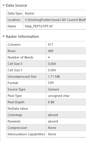

Hello everyone I am trying to set up a process where I can export out pdfs from a spatial map series, use the pdf to tiff tool, and then convert to another raster to create a jpg that can be used to create a mosiac. My tiff from the pdf to tiff is a 4 band tiff while a manual map export creates a 3 band tiff.
when using my conversion tool I get the following error:  ERROR 000446: Output file format with specified pixel type or number of bands or colormap is not supported. Refer to the 'Technical specifications for raster dataset formats' help section in Desktop Help.
Failed to execute (CopyRaster).

These are the raster outputs... they look very similar to me.
