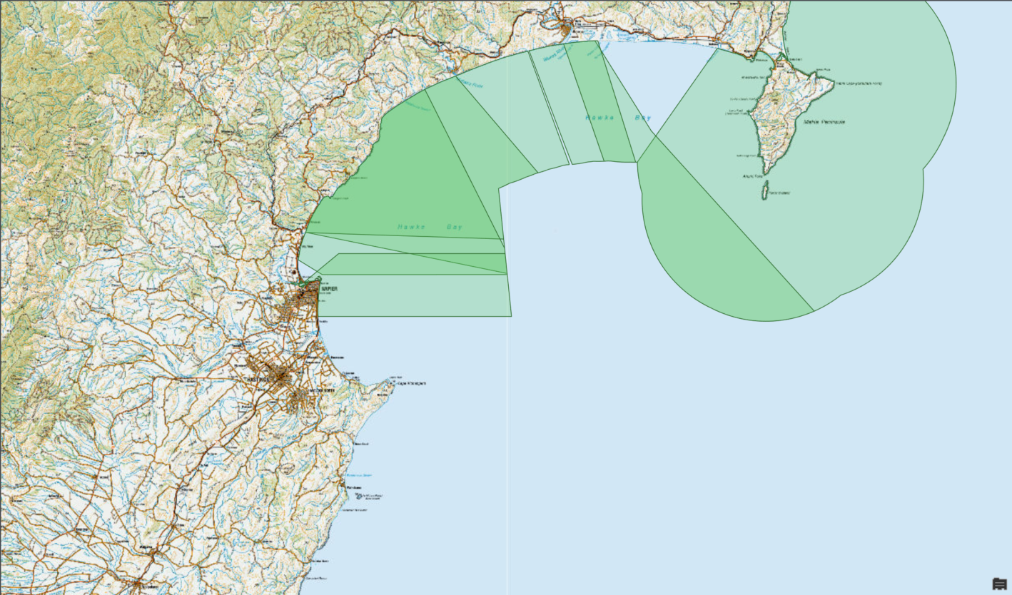

We use the same PCS for all of our work, but in some of these projects it is 'skewed', please see the comparison below:

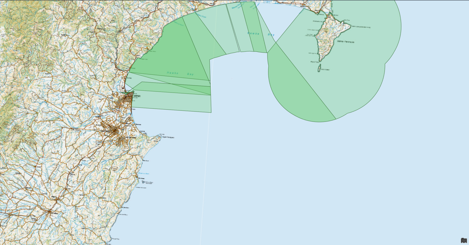

The second image is from the 'skewed' project. As you can see the basemap is oriented identically, yet the features are not. The coordinates themselves are the same, i.e. the coordinate at the south-eastern corner of the layer is identical in both projects.
The coordinate systems and transformations in each of the projects and layers are, as far as I can tell, identical. I have trawled the various settings and properties menus and cannot find any differences whatsoever between the projects.
This is driving me crazy - I would appreciate any help.

check for map rotation
Set map properties—ArcGIS Pro | Documentation
if there is no rotation the lower left and upper right should be the same if the maps have a fixed extent in all the projects (assuming coordinate system etc is identical as you have reported)

It could be a number of things, but perhaps at one time someone was exploring with 2D navigation which has a rotate option.  See the images in
Use the on-screen navigator—ArcGIS Pro | Documentation
When things go strange like that, it is always best to delete the map(s), open new fresh ones and readd the data checking everything as you go... or rotate your head slightly to straighten things up
