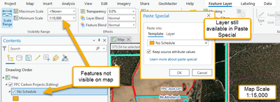

What about setting a Minimum/Maximum Scale for the layer? This way, it hides the layer when you're working unless you zoom in/out to a point within the range of scales you set, but it is still technically turned ON so you can paste features into it.

Thanks Lindsay, This is a great workaround. I set Min to 500,000 and regen is much more manageable. I appreciate the Feature Layer custom screenshot. Regards, Derek.
