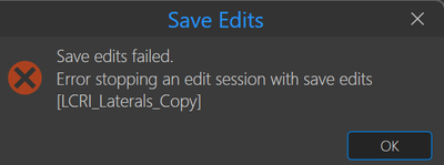

Hello I was wondering if anyone might have a solution. I am attempting to do a paste special in pro. everything works fine until I attempt to save my edits when I get this error.
For context I am running Pro 3.5.1
any ideas?

Is the LCRI_Laterals_Copy a required dataset? If so, would you be able to right-click and remove it? Along those lines, is the project in Read Only mode? I would try giving the project a restart as well as considering updating Pro to 3.5.2, it may have a patch that fixes something like this!

thank you, this solution seems to have worked!
