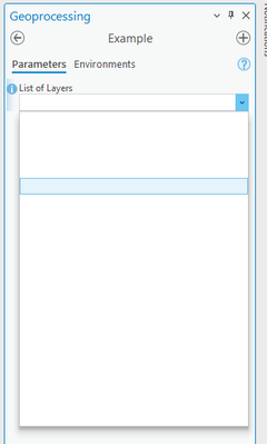

Pretty basic stuff. However, when you open tool, the parameter is sometimes populated with only blank entries. See below.
After opening the tool with an active map view window open it fails to populate, if you open the tool properties and inspect the Value List it should have the list of layers from the map view. To get the tool working, I enabled the Multiple values checkbox of the parameter, reopened the tool and the layers were all listed, then disabled the Multiple values checkbox again, and the layers were still listed properly. However the parameter breaks again if you add more layers to the map.
