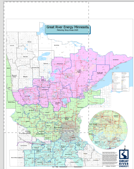

I am trying to export and or plot a 34 x 40 inch plot.
When I show the margins it shows a dashed line  that is much smaller than my plot.  and when plotted it will print on 34 x 40 but clipped to this page size.  In Pro it is setting the page size to 22 x 34.  When I created the layout I have specified 34 x 40 and tried it as Ansi E 34 x 44.  Selecting Fit to does not change anything.  Earlier today I did something to get rid of that dashed line and expand it to the margins, but cannot remember or get it to work a second time.  I do not have any elements outside of the paper

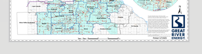

My apologies I should have followed up.  I figured out the issue.
Margins, rulers, and guides can be toggled in the Show tab under Layout.
It turned out to be a setting on the plotter.  (very nice laser jet plotter that we share with Engineering)
There are saved profiles and the default is the Engineering Default Page Size which is ANSI D
I created a new GIS Profile that specified a modified ANSI E at 33.5" x 39.5".  The plotter can do a minimum of .18" margin but I used .25" to make layout alignment a little smoother.
We had not had this issue in the past but I believe one of the Engineers added a default profile. Not a big deal now that we are aware of it.
In the below clip you can see that the new page size and how it lines up nice and neat.
