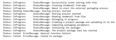

Hello,
I have been trying to package a very simple project and keep on getting errors at the very end saying "Status: Failed ErrorMessage: General function failure" and "Status: Failed ErrorMessage: Failed to package." When I run the analysis tool there are no errors. I've tried restarting everything multiple times and I have no history items or toolboxes included. I'm not sure what I'm missing I've pasted an image of all the status messages.

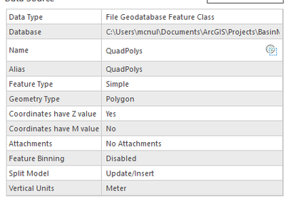

Can you provide more details? What version of ArcGIS Pro? What does your project look like (what does it include in terms of layers)? Are all the appropriate fields filled in for the Package itself (like summary, tags, etc.)?
KatherineMcNulty
I'm using ArcGISPro 2.8.3. The project includes 6 feature class layers of polygons (see below-all layers have the same properties). I have projected everything and the map in the same coordinate system. I added a summary and tag, but I created them myself- both are labeled as"BasinOutlines."
