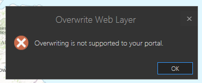

I've attempted to 'Overwrite Web Layer' but I get the error message 'Overwriting is not supported to your portal':
Overwriting is not supported by your portal.
I haven't been able to find any other instances of this error in GeoNet or Google. I am able to overwrite services in ArcMap.
I notice here that 'Currently, ArcGIS Pro only supports overwriting web feature layers that do not reference registered data.' - does this mean Map Images cannot be overwritten at all, regardless of where the data comes from? This might be true, but the error message above points to a bigger issue.

I did encounter this issue when I was trying to overwrite our cadastral editing web layer. Deleting the portal connection and re-adding the portal connection and logging in again did the trick.
SamAppiah
Mind you I am working in ArcGIS Pro 2.9.2
