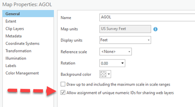

If you added/removed/changed/moved any layers in the map, did you ensure the Allow assignment of unique numeric ID's....... was enabled so that all the existing layers retain their original ID's?
If not, the layer ID's could be different than when originally inserted into the web map and can cause load issues.
