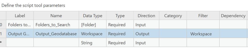

And here are the simple parameters used

After some brief testing, I am getting the same behavior as you describe when the parameter direction is set to Output (i.e. The geodatabase is created/overwritten every time).
The tool functions as expected when the direction is set to Input instead (i.e. The geodatabase is only created if it does not exist).
Are you planning on using this script tool in Model Builder?  If not, maybe you can just set the direction to Input?
If you are planning to use with Model Builder or chaining with other tools, maybe you can use SetParameter to add the output geodatabase as an additional parameter set to Output?
