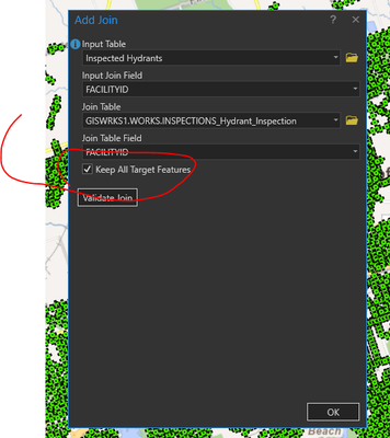

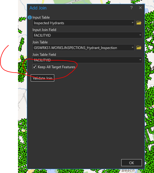

Hi,
I have a table with a definition query (to filter based on a date field) and a point feature class.  When I join the table to the feature class I select "Keep all Features" (ie. an Outer Join) but after the join finishes I am only left with the features that have a related record in the table.
Isn't "Keep all Features" supposed to do just that....keep all the features??

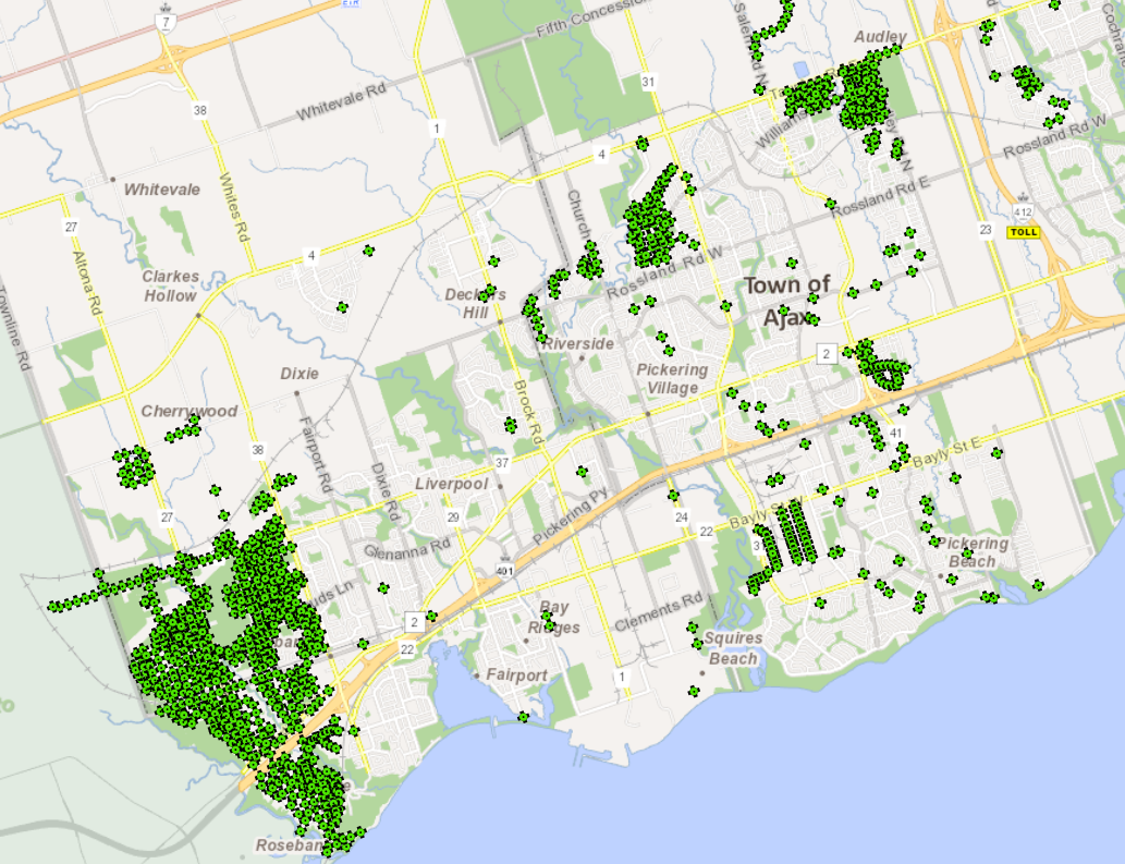

Before the join:

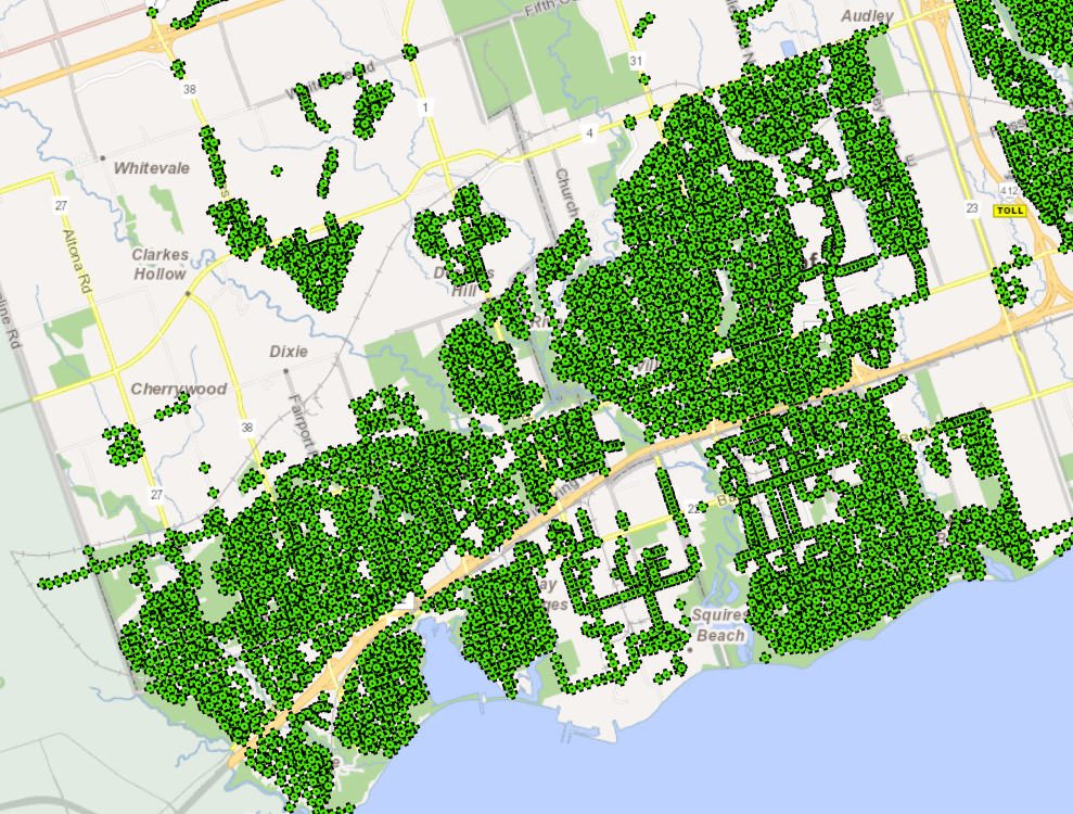

After the join:
Can anybody explain what is going on?  This is with ArcGIS Pro 2.8.1
