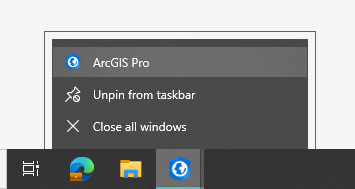

If I need multiple instances of Pro running, I just right-click on the icon in the taskbar (Note that these are all separate blank projects)
