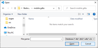

In VSCode, I use CTRL+Shift+P to open the textbox at the top.
Choose SQLite: Open Database >> Choose database from file.

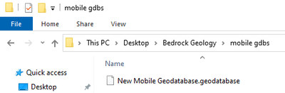

Browse to the folder that my mobile geodatabase is in.
Problem:
No files are listed; I can't see/open the mobile geodatabase.
I assume VSCode can't see my mobile geodatabase because it's file extension is .geodatabase, not the usual .db extension for SQLite databases.
How can I open a mobile geodatabase using VSCode?

File->Preferences->Settings (or ctrl-,)
Search for sqlite and add the extension
