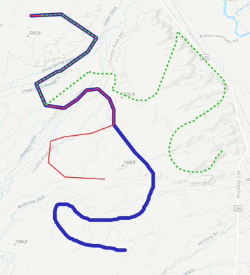

I’m using ArcGIS Pro 3.5 to map six bus routes, each represented by a single polyline in one feature class (i.e., six features total). Some routes follow the same roads, so I want to visually separate them using symbology offsets.
https://imgbox.com/WSfWw7ip

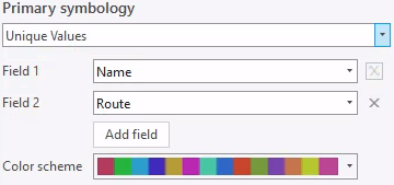

I applied Unique Value symbology by route name and used Symbol Layer Drawing to assign different stroke offsets and colors to each route. The goal is to show overlapping routes side by side clearly.
The problem: some offset lines are missing segments or appear broken. The offset size doesn't matter, some lines break visually no matter what. The screenshot is one of six bus lines symbologized.

I do not see an option to edit. Here is the screenshot:
https://imgbox.com/bfAPIkjv

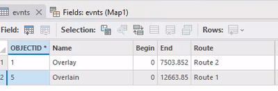

You can then make an event table. You need a field for the following: Route the event occurs on, Event Name, Begin Point, and End point.
You can then populate the event table using the "M" values. To find these, select each feature and open the attribute pane. Then, you can check the geometry of each vertex, which will include the M value. Clicking on the vertex will flash it on the map, so you'll be able to tell which one you actually want.

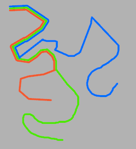

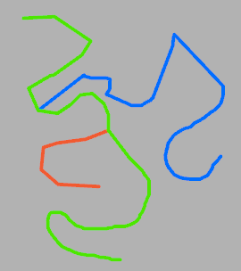

Then you can make an event for each overlapping segment to offset or move it how you like (Pro tip: you may want to try using a VERY small extension effect to connect the offset segment to the main segment), and create a route event layer to symbolize each event.
Pro tip: You will mess this up a bunch, but the route event layer will change as you update the event table. The only exception is if you change the underlying geometry; then it may get funky.
You will want the symbology to match the underlying route, but you will want to symbolize by event AND route so that you can adjust each one as needed.
BeforeAfter
