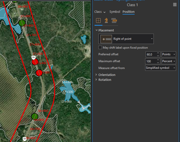

Hello all,
I am struggling to get labels to be positioned properly in my map. I want all labels to show and be offset by 60 pts. In the position settings I have the box checked under "Unplaced Labels" to never remove. In the position settings, I have it set to "Top right of point" with an offset of 60 pts. However, when the unplaced labels are added, the offset is not applied.
I don't understand why the labels are not being placed in the first place. I have checked weights and priorities for the labels and they are the highest of both.
Unplaced labels shown in red, unclear why they can't be drawn at the offset:

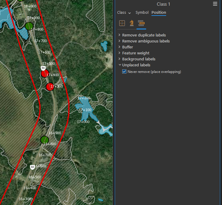

Labels once all labels are forced to be placed with the same offset setting:

JesseWickizer
Since you have a relatively large offset, point ambiguity may be preventing label placement because the label may be close to other points.
In 3.1 there is a new Remove ambiguous labels control to customize how this works or turn it off.
In your case set this to Do not remove.
