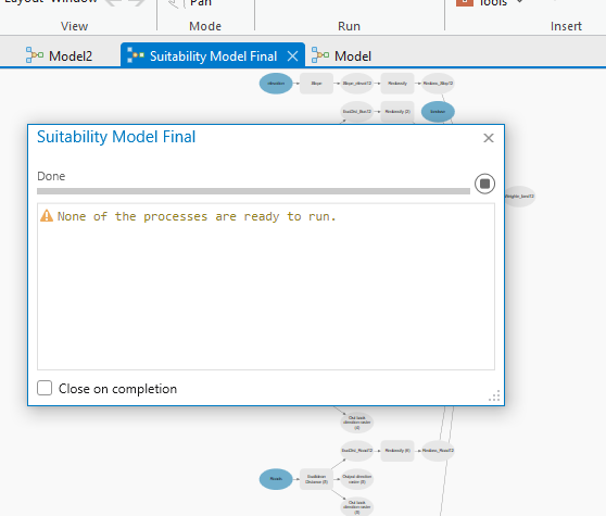

I created a Model in ArcGIS Pro and it run well and give desired result and when I saved it and reopen it and then running model cause the disappearance of the colours of flowchart of model builder and It says "none of the processes are ready to run" and it gives the error that <input dataset> does not found or invalid dataset, but our is at its place, Now I came to know that whenever I saved the model and then reopen it it forgot the path of the dataset I think there is a issue with the saving of the model, I also tried saving it on another location, I tried every saving technique of ArcGIS Pro but the problem still remains please help me with this problem. Moreover, I am using the latest version of ArcGIS Pro. Someone please help me. Also I am using spatial Analyst techniques to make a suitability map.Screenshot 2023-04-13 151355.png

When one sees this error message, it means that one or more of the input datasets are not available.  This can be a result of not having access to a shared network drive or the datasets are coming from more than one map view in the ArcGIS Pro project rather than from just one map view.  Make sure the map in question is open when you run your model as a geoprocessing tool.  What is the result?
Also, are you running the model while in ModelBuilder or running as a geoprocessing tool?
MehboobAslam
 I am running a model in modelbuilder
ashmarti
I know this was posted in 2023 but for anyone else having this issue - I found that I was coming to this problem because I grouped some of my map layers. Once I ungrouped them, I was able to get the model to validate and run.
croush2024
Wow! Thank you for posting. I ungrouped in map contents as you suggest and the problem went away.
