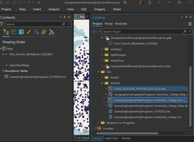

Installed the latest version of ArcGIS Pro as of this date (July 26, 2022) - today.  I have some spreadsheets in a folder that I planned to integrate into a data layer but, when I literally touch the item in the catalog it sets off a process and just spins...
I suspect that the ExcelToSQLite64 may be implicated.
It fires up and when I kill ArcGIS Pro (it's hung - hangs for a long time... over an hour), that is still running.
It consumes a very high amount of power and I have to kill it separately.  Then I have to reboot my machine to keep it from "thrashing"...
Anyone else having this issue?  I will be reporting this to Esri Support but wanted to ask if anyone has any thoughts.  It doesn't matter which Excel file I "touch" - can't do anything with it - anyway - it just causes this issue and I have to kill my project.

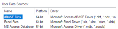

I’m running 64-bit Windows 10 with 64-bit Microsoft Office 365 (installed using Click-to-Run) and trying to read Excel files in ArcGIS Pro 3.
Given the info above and following Esri’s decision tree (ArcGISPro_Excel_Decision_Tree_Guide_Update.png), I installed 64-bit Microsoft Windows .NET 6 Desktop Runtime and I quietly installed the Microsoft Access Database Engine 2016 Redistributable 64-bit driver before installing ArcGIS Pro v3 (clean install; not an update).
I double-checked my installations:
I ran odbcad32.exe to check my drivers; everything looks good.
Yet …  ArcGIS Pro 3 throws a hissy fit every time I merely touch an Excel workbook. It hangs indefinitely. There’s no way to cancel out.  I need to open the task manager to kill the application.
Please, what am I missing?

I figured it out (for now).  I noticed I had a newer version of Microsoft Access database engine 2016 redistributable 64-bit (208 MB) -- a version that was installed a month ago (presumably during an update).  I uninstalled it then quietly installed the recommended version (152 MB).  ArcGIS Pro 3 and Excel are playing nicely now.
I'm going to keep an eye on that engine because I'm assuming it will get updated again at the next cycle.
