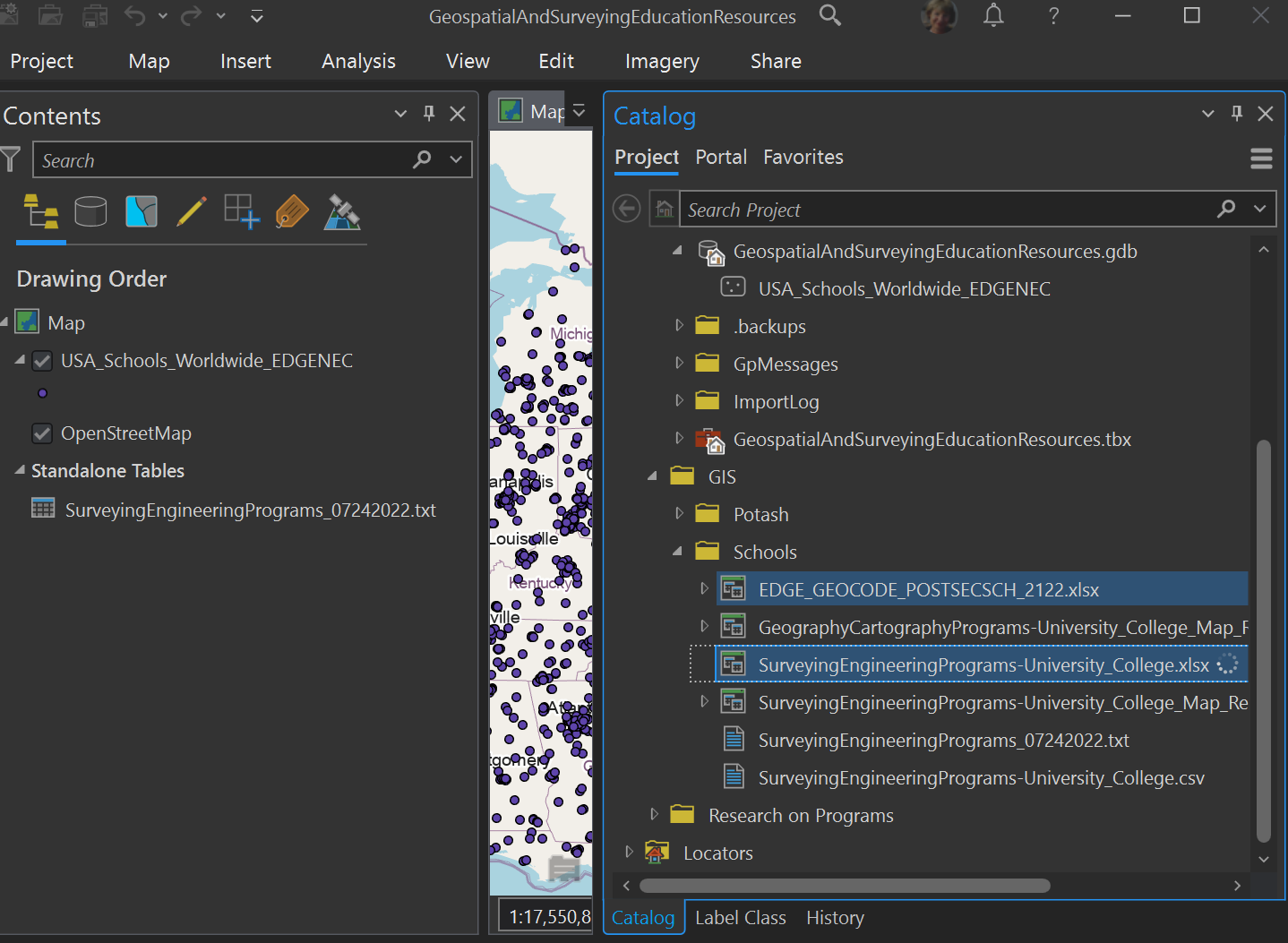

Installed the latest version of ArcGIS Pro as of this date (July 26, 2022) - today.  I have some spreadsheets in a folder that I planned to integrate into a data layer but, when I literally touch the item in the catalog it sets off a process and just spins...
EllenNodwell_IntegraShare_0-1658864075833.pngEllenNodwell_IntegraShare_0-1658864075833.png

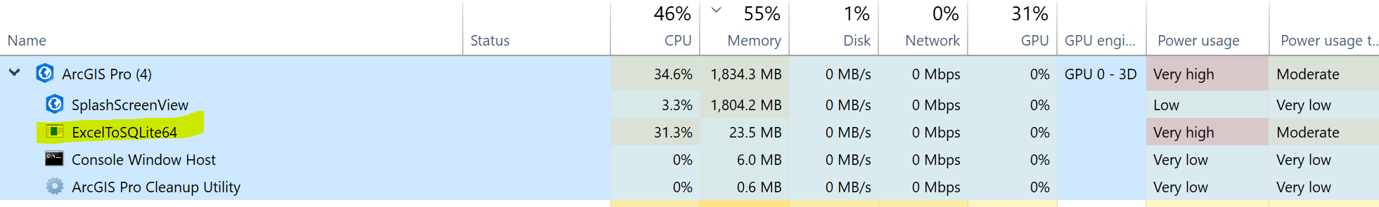

I suspect that the ExcelToSQLite64 may be implicated.
EllenNodwell_IntegraShare_1-1658864149086.pngEllenNodwell_IntegraShare_1-1658864149086.png
It fires up and when I kill ArcGIS Pro (it's hung - hangs for a long time... over an hour), that is still running.
EllenNodwell_IntegraShare_2-1658864236404.pngEllenNodwell_IntegraShare_2-1658864236404.png
EllenNodwell_IntegraShare_3-1658864312323.pngEllenNodwell_IntegraShare_3-1658864312323.png
It consumes a very high amount of power and I have to kill it separately.  Then I have to reboot my machine to keep it from "thrashing"...
